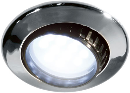

I ended up ordering some great little LED lights from http://sailorsams.3dcartstores.com/. Here's one of the reading lites I ordered (only I ordered it with a Gold bezel):
We took one out to my build last night and hooked it up temporarily to see if it was going to be bright enough. WOW! Plenty bright for reading at night. 1.6 watts puts out a lot of light. They're small but they're good looking and I think at .13 amps they're going to be pretty easy on my Amp Hours too.
