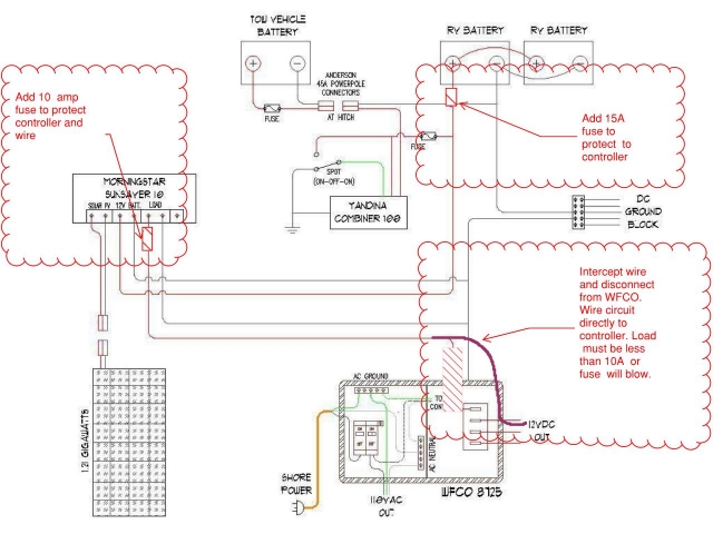

Postby absolutsnwbrdr » Mon Feb 11, 2013 11:58 am
Bruce, forgive my ignorance, but can you shed some light on the Sunsaver hookup. I read through the manual, but am still unsure of the "load" connection. :?
Do I just tie the Sunsaver in through the battery connection and leave the "load" unconnected?
Or do I wire from the batteries, to the Sunsaver, and then hook the WFCO into the "load terminals?
Am I getting greedy, trying to have the option of charging 3 different ways? :twisted:

Postby bdosborn » Mon Feb 11, 2013 2:05 pm
absolutsnwbrdr wrote:Bruce, forgive my ignorance, but can you shed some light on the Sunsaver hookup. I read through the manual, but am still unsure of the "load" connection. :?
Your first diagram is one of the ways to wire it - without any loads on the "Load" terminals. BUT, you need a 15 amp fuse between the controller and the battery . You're not required to have a fuse on the PV panel since you only have one panel and the panel short circuit current is less than the wire is rated for, assuming you use a #12 wire. (1.21 gigawatts is a pretty big panel though :shock: )
The second diagram won't work right. You would need to remove the load wire from the fuse on the WFCO and wire it directly to the "load" terminal. See my comments on your wiring diagram.
You can charge from any combination of the three sources with this arrangement. You can plug in, charge from the vehicle and charge from the PV panel all at the same time. Or just charge from the PV panels, it's all automatic.
P.S. Nothing says you *have* to use the "load" terminals, its just might be nice to rig a "oops I fell asleep with the TV on" circuit.

Postby absolutsnwbrdr » Mon Feb 11, 2013 2:16 pm
bdosborn wrote:Your first diagram is one of the ways to wire it - without any loads on the "Load" terminals. BUT, you need a 15 amp fuse between the controller and the battery . You're not required to have a fuse on the PV panel since you only have one panel and the panel short circuit current is less than the wire is rated for, assuming you use a #12 wire. (1.21 gigawatts is a pretty big panel though :shock: )
As always, you're a big help Bruce! I'll stick with the first diagram (with fuses), because KISS is good! The first one will also be alright charging from any source, correct? :thumbsup:

Postby bdosborn » Mon Feb 11, 2013 2:34 pm
absolutsnwbrdr wrote: I'll stick with the first diagram (with fuses), because KISS is good! The first one will also be alright charging from any source, correct?
Yup, make sure and post some pics when you get it installed! :thumbsup:
