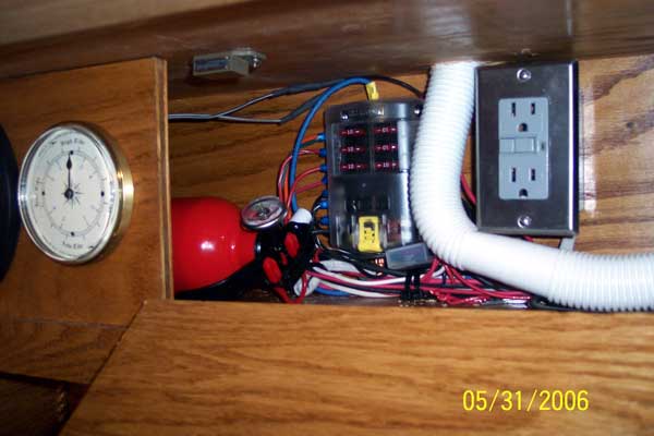

greasywheats wrote:Yikes- 12 circuits! either you have a lot of expansion space or you are remotely controlling the US satellite program from your teardrop! 8)
I am definitely going to add an auxiliary panel for my remaining fixtures.
Every light & 12 volt plug has it's own circuit and I have some extras. You can never have too many the way I look at it. :) Danny

Postby Sonetpro » Wed Oct 18, 2006 7:27 pm
I used the marine panel also. 6 circuits.
If I was going to splice I would only solder and shrink tube. I hate electric problems.
