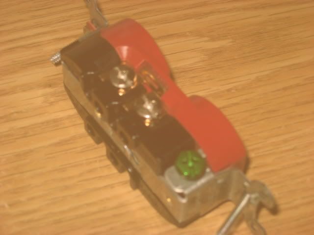

Afoxworthy, I bought fairly expensive, pretty red outlets. They have screws to tighten down and hold the stabbed in wire. However if they come loose, I am pretty sure it will kill my GFCI and blow the breakers first. I hope. Oh and I do tape around the thing so the screws are covered.

Miriam C. wrote:... I bought fairly expensive, pretty red outlets. They have screws to tighten down and hold the stabbed in wire...
The stab-in holes appear to line up with the screw positions, which isn't surprising, but does the tip of each screw actually run down into the stab-in hole, so that it clamps the wire in there? That would make it a set-screw connection, and would be much better than the typical stab-in design.
Miriam C. wrote:... However if they come loose, I am pretty sure it will kill my GFCI and blow the breakers first. I hope...]
If loose wires are floating around, and the live side (line) hits ground, then I suppose the GFCI will trip (since line and neutral will not carry the same current) and even the breaker (if enough current flows).
Coming loose (if a screw loosens) might be the concern with this particular "stab-in" design, where a wire looped abound a terminal screw will stay in place.
I think the concern with more typical stab-in terminations is that they may not contact very well (they certainly don't fall out easily if properly inserted); in that case, they would just have excessive resistance, causing open-circuit faults and/or building up heat (a fire hazard). I don't see why the GFCI or breakers would trip in the case of poor contact.

Postby Miriam C. » Sun Apr 27, 2008 2:08 pm
:o :lol: There is a plate under the screw that clamps on and holds. It is not a partial stab in. They are Hubbell and wonderfully made. For those who want red, they aren't expensive per each but I had to order ten and I got a discount. Then you had to buy ten wall plates :? It isn't fair but no one had them.

Postby brian_bp » Mon Apr 28, 2008 5:22 pm
Miriam C. wrote:There is a plate under the screw that clamps on and holds. It is not a partial stab in. They are Hubbell and wonderfully made...
Thanks for the info.
I guess that would be Hubbell, presumably the HBL8200 series. It looks like they have a lot of nice stuff. I don't know why the requirement to buy specific cover plates... or is that just to match the red?
