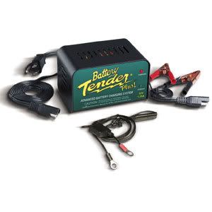

I think where I got confused the most was that when you view the pic of the BT, you see quite a few connections on the picture...are these just "options" and all are not necessary? I see the little wires that look like they can go to the fuse, but i also see clamps like you would see on a normal battery charger.

rhltechie wrote:I think where I got confused the most was that when you view the pic of the BT, you see quite a few connections on the picture...are these just "options" and all are not necessary? I see the little wires that look like they can go to the fuse, but i also see clamps like you would see on a normal battery charger.
Yep, you got it Mandy. The DC output of the charger terminates into a two pin connector, you choose either the alligator clip leads or the ring lug leads and plug them into that connector. If I recall correctly I ended up cutting the output leads shy of the connector and added my own ring lugs for termination. :thumbsup: :thumbsup:

All b/t's as far as I know come with clamps and terminals as bat connecting options... the 12v line out of the b/t has an electrical connector in the middle of the output line so you can plug in either option...
