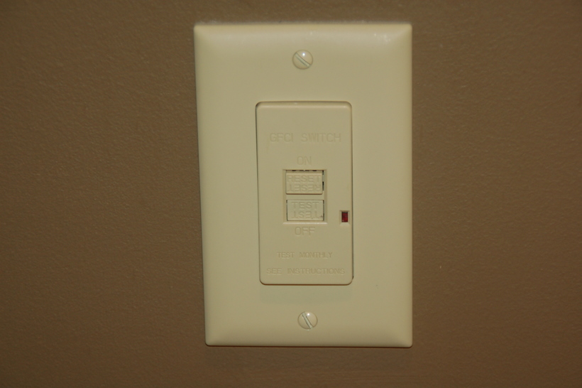

Another good precaution, especially with a lot of metal around the trailer electrical system, is to have a GFCI in the trailer right after the power inlet. One reason for this is that most campground power pedestals do not have a GFCI, just a circuit breaker.
With the short to ground you seem to have, it may not be apparent immediately without a GFCI. But if one touches the trailer metal while standing on wet ground it could shock the person. :shock: With your own GFCI installed it will trip right away if there is a short to ground (ground fault) and not shock the person touching the trailer. :thumbsup: Home Depot and Lowe's sell the 20 Amp GFCI’s for about $10. They come either plain or with outlets. I use the plain type before my circuit breakers. They are sold with either 15A or 20A rating. This link is a photo of a plain one.
