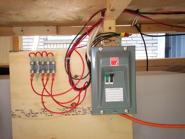

BPFox wrote:Actually 30 amps is not overkill for any size trailer if you plan to equip it with extra electric goodies. For example, I plan to install an electric heater as well as an air conditioner. I will be using a two breaker 30 amp box for this. I like the looks of the panel style breakers shown here, but I am kind of cheap and I already have the panel box.
I am using a small 4 breaker, 60A box. One 30A breaker, (green) fed in reverse, as the main input breaker. 3 15A breakers. 2 feed a split receptical for fridge and micro. One feeds two other convenience outlets. NOTE: the other two breakers have not yet been installed in this progress photo.
Should the convenience outlets be near max, I would unplug the micro to do another high amp appliance. Works good for me.

This is a good example of what we are talking about. This is a 60 amp box that is being used for a 30 amp service. I'm not sure what you mean by "feeding in reverse" your 30 amp breaker. I will assume you are using the 30 amp breaker as a "main" to power up the panel. While there is nothing wrong with this, it is redundant since your RV power source should already have a main breaker. This method does eliminate the need to jumper your breakers so to each his own as they say.
That said, it looks like you are also running 12 dc wiring. I am looking at red wires (12 v +) feeding a fuse block and black wires (12 v -) tied off together above the breaker panel with a wire nut. Is this correct? If it is I do have some concerns. First, it looks like the supply side wire is the same size as the individual circuit wires. While individual circuit wire only needs to be the size required for that individual circuit, the supply line needs to be large enough to handle all of the circuits together. Also it looks like you are bundling your 12 volt wiring and your 120 volt wiring together This is not a good idea since it could have a negative effect on your 12 volt components. Just some things to think about.

BPFox, you are correct in your analysis of what you see. The 30A is the main feed breaker. That protects me in case of input problems from a campground. Necessary? Not likely, and if I find I need more capacity, I may well re-do it a bit.
As for 120VAC being bundled with 12VDC, it only appears that way. Indeed where you see all the negatives bundled. It is just tucked there to keep out of my way during construction.
The system in the picture is a mid-point to running and testing. I am waiting to pick up a neutral/ground type buss bar to tie the negatives together properly. The main feed to fuse block is currently 14ga fused to 20A. It will be 12ga. The rest of the 12V branch circuits will remain 14ga fused to 5, 10 and 15 amps. THe 5A is for the 2 fluorescent fixtures within the box. 10A will feed a modified 14G extension cord to go to the tent for a small lamp and mini B&W TV. The 15A feeds the dual 12V outlets in the galley.
The simple orange cord was in place temporarily also. There is now a typical RV extension wired into the box. Oh, and I still needed to jumper the two halves as the main buss bar is divided.
