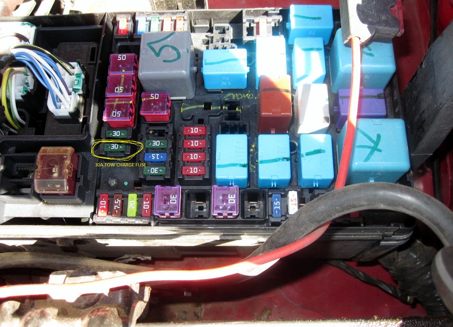

My 2008 Tacoma has the factory tow package (with the 7 pin electrical connector). It was pre-wired with the switched 'hot' wire (charge wire) in position #4 (1 o'clock position when looking toward the connector from the back of the truck). Black wire I think. Best way to check is with a test light (or multimeter). You should not have any power to the connector pins when the ignition is off. With the ignition turned on if your truck is wired like mine, the #4 position pin will show power. Mine also has a 30A fuse in the box just behind the battery for the tow charge line.
Here's pic of the fusebox showing the charge fuse (circled in yellow)
