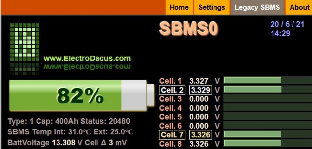

I've been running the same thermostat controlling four bee heaters and my BMS for a couple of months now. No charging, heating, or loads, I wanted to see how long it could sit without the battery getting discharged. I'm at 82% charge on my 400 a-hr battery. The thermostat itself doesn't use hardly any power.
