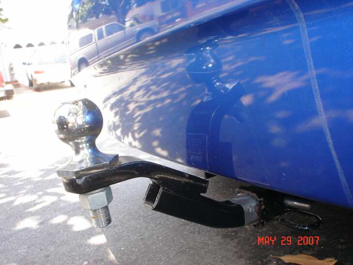

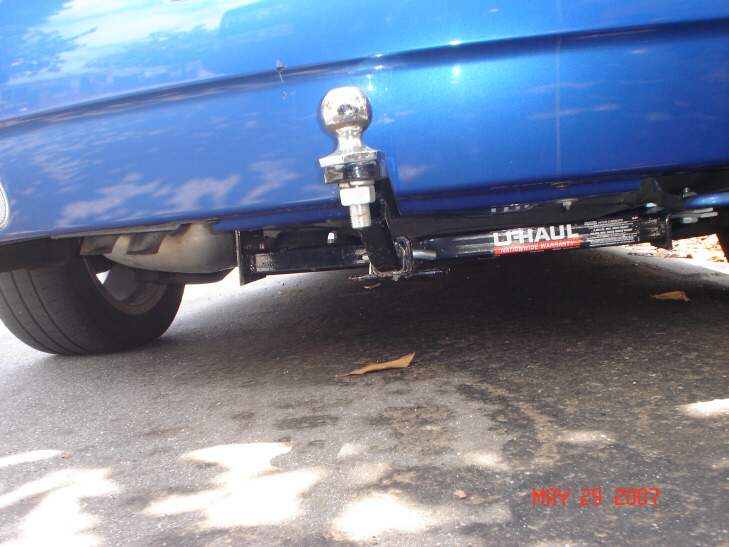

Postby Nic » Thu Oct 18, 2007 1:37 am
packerz4 wrote:hello dwe!
do you have a pic of your beetle's hitch? i'm wanna put one on my '99 tdi. advanced auto said the could order me one, but i was a little shocked at the $200 price... :o
where did you get your hitch? what part of Wisconsin are you from? I'm from Reedsville (between Appleton and Two Rivers), but travel all over the state (and North America) for work...
i look forward to your reply.
thanks!
tk
I tow with my 2001 Beetle. I had trouble finding a hitch also. But ended up getting one from u-haul. It cost me about $165 i think. Give or take. It came with EVERYTHING i needed though even the drop i think also the ball. I put it on myself. It was easy. But you do drill holes in the spare tire area. I had U-Haul hook up the tail lights after going crazy trying to figure it out on my own. The lights only took them an hour or so to do. That cost me about $60. But they mounted the plug inside my trunk. So i have the wires hanging out of the rear hatch when i tow. Kinda sucks.
