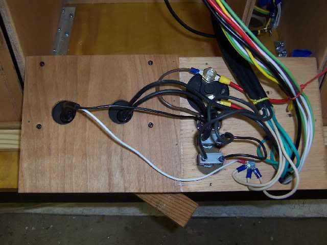

Postby madjack » Fri Jan 18, 2008 1:12 am
...we buil/build our own...for example..............
...and the rats nest behind it...........
madjack 8)

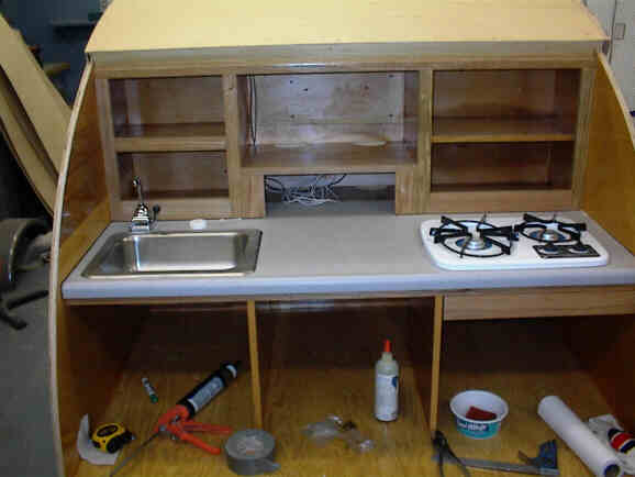

Postby Leon » Fri Jan 18, 2008 3:19 am
I mounted mine on the bulkhead behind a kitchen drawer. If you look in the picture, the small space just above the counter in the middle where all the wires are is where I mounted mine. If I need access to it, I pull the drawer out till it stops, hit two little release levers on the slides, and remove it from the slides. That allows me access without having to crawl under anything yet the fuses (and some other misc. wiring) is hidden from view under normal use.
The drawer is a few inches shorter than the space so when it is closed there is room for the fuses behind it. I also have wiring in there for a couple other light functions plus a 12v outlet that mounts in the flat portion just to the side of the drawer.
