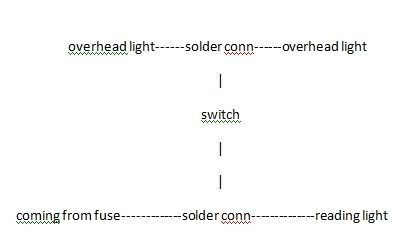

hehe..i think i am coming around. now..one more question...if i need to throw a switch into the mix..can i do this?
does this even make sense in an ascii drawing? bascially can the "rung" of the ladder go to a switch instead of just a light and then branch out after the switch to two lights?

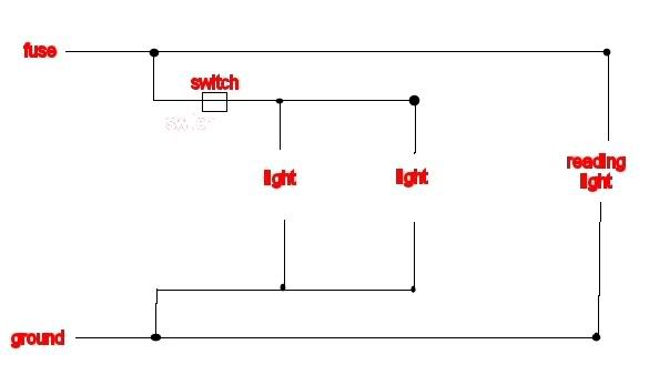

Postby tinksdad » Tue Aug 19, 2008 12:36 pm
Couldn't do this one in ASCII. If I am understanding your wishes, you want to turn on two overheads with one switch and have the reading light separate.
Think of it as a mini ladder within the ladder. I put the switch in the diagram to turn on the two lights but not the reading. The black dots represent solder points.
If you want the two overheads controlled separately, you would have to have two switches (one for each light) and move them to the rungs of the mini ladder. Also, unless your reading light has a built in switch, it would be on whenever the battery is hooked up, so you might consider a switch in that rung as well. If the lights have built in switches, it's immaterial. You're back to a single ladder.
