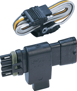

If all you need is a 4-pin flat trailer light wire, see below. If you're looking to tap into the truck's auxillary power circuit to power your trailer, I'll have to do some more digging.
Cmdr wrote:....Will I need to cut into the exisiting wire?
Nope.
Is there a simple way to break into the exisiting wire?
Yup.
Is there a plug adapter that make a connection between an existing plug connection?
Yes. All you need is a T-Connector. It plugs inline with an existing plug under the back of your truck.
According to the manufacturers website, the one you need is made by Hoppy, Part # 41125.
The Hoppy brand is carried by most every auto store. It runs about $15-20. There may be other brands available, but I've always used these, and never had any problems with them.
Hope this helps.

Yes sir got it taken care of....Bought a Hoppy "T" plug that fits right in.
