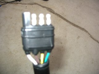

I'm having a problem rewiring my trailer.
When I turn the cars running lights on, the running light vehicle fuse blows. I've ground each light to the trailer frame. I tested each light before hooking it up and the light worked.
Hoping the wiring gurus have some sage advice. Do I have a bad ground or a short in the rear lights. Do I need to ground the trailer in a different way?
I've wired it for four flat.
The main ground is here on the frame.
The front running lights are spliced here to the brown wire on each side.
The front running lights are each ground to the frame.
The rear lights are here. Red is for running light and black for turn/brake.
Again, rear lights ground to the frame.
Any suggestions would be most appreciated.

Postby madjack » Sat Apr 11, 2009 9:04 pm
...blowing fuses is usually a problem with a short circuit...that would be the place to start your search....... 8)
Posts: 15128
Postby starleen2 » Sat Apr 11, 2009 9:19 pm
Possible live wire shorting to ground. Check all wires for bare copper or places where a wire or cable could be pinched. By any chance do you have a pinched wire somewhere? I had that happen on a NEW trailer. A pinched wire that grounded and kept blowing fuses. The wiring worked just fine unitl I tighened the floor down to frame - and bingo - instant power to ground short! Check everything - don't assume - my ground problem was in a spot that I couln't even see. Almost drove me nuts until I did an continuity test on the strand and knew for sure.

Postby bobhenry » Sun Apr 12, 2009 1:06 am
It appears all of your ground connections are accessable. If this is true unhook all of the grounds to each individual light while leaving your main ground connected. It avoid damage to your tow vehicle use a battery charger to power the brown lug on the 4 way flat. ( Hot to brown and ground to frame). Touch each ground wire to it's ground if the light functions it is not the problem child. Continue until each light is tested you will find one will not function and the ground should spark excessively when connected. This is the culprit!
You will most likely find a screw ran thru the hot wire or as has been said a wire pinched thru the insulation.
Postby Forrest747 » Sun Apr 12, 2009 2:02 am
Ok i noticed you spliced into several of the wires, normally not a big deal, but sometimes the clip that covers the press down, does not stay down. making contact with frame and pow. Just a thought.
