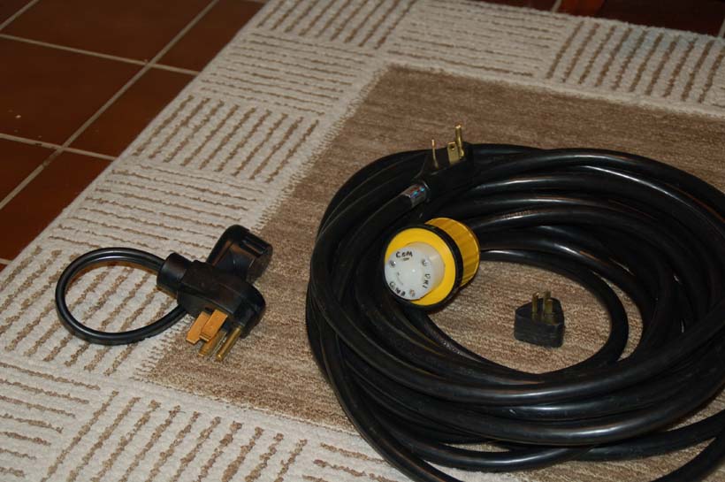

This is the inlet I used. Marine and RV power inlets use the same configuration for 30A 125V. It is nice but not inexpensive.
Below is a photo of the power cord that attaches to the inlet. The yellow female connector plugs into the male power inlet that has three blades. The black ring on the yellow connector screws onto the power inlet to form a watertight connection. Also shown are two optional adapters. On the left is 50A male to 30A female that I have not needed so far. The small adapter inside the coil is 15A male to 30A female that has been useful at home, but so far the campgrounds where I stayed all had 30A outlets.
