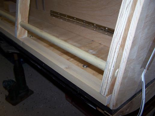

I'm restoring a '47 teardrop and it's time to do the wiring. There are a few places where it would be most practical to route the wood and inlay the wiring. Is there any problem with doing this for short runs (6inches max)?
I'm using stranded THHN. The particular wire I'm working with right now is a 14AWG that will see 3.4amps maximum. This is a 12v only system. I'd be doing a 1/8"W x 1/8"D routed straight path that the wire lays in. It will then be sandwiched with 1/8" ply.
Edit: here's a picture showing what I'm doing.
Thanks for any info/experience,
Clint

You can just see the wires in this photo on the side of a tear. I rout all my wires along the sides and terminate the groove to where a cabinet is inside, then drill a hole thru . That way you don't see any wires on the finished inside walls. I cover the groove/wire with a layer of tape, and the aluminum skins cover everything. I haven't used THHN, but 14-16 ga lamp cord, so each run has a ground and hot.
