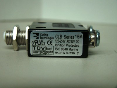

Postby Jerry Bleeg » Mon Feb 08, 2010 8:19 pm
Thanks Ageless, but all I really want of the power strip is the circuit breaker. I already have my duplex box mounted with the GFCI, and I have the Marinco shore power plug in on the side of the trailer.
Would something like this work if I mount it inline of my incoming black(hot) AC wire.
I would mount it inside my front cabinet and it would be between my Marinco shore power plug and the GFCI duplex box.

Coop and Wannabe, I like both of those ideas. In the end, I think this one I found on ebay is the way I will go. Looks like it will be easy to mount into a handy box, and I like the screw lugs.
