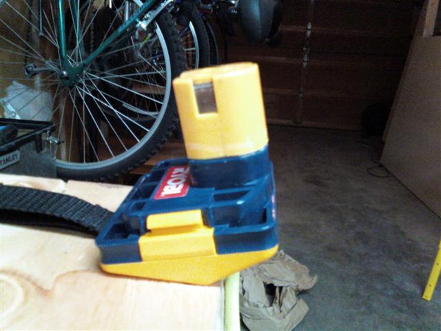

Hello everyone, I wanted to share a little trick I did to help out during my build.
I like many use a set of battery powered tools. Waiting for a battery to charge it a killer.

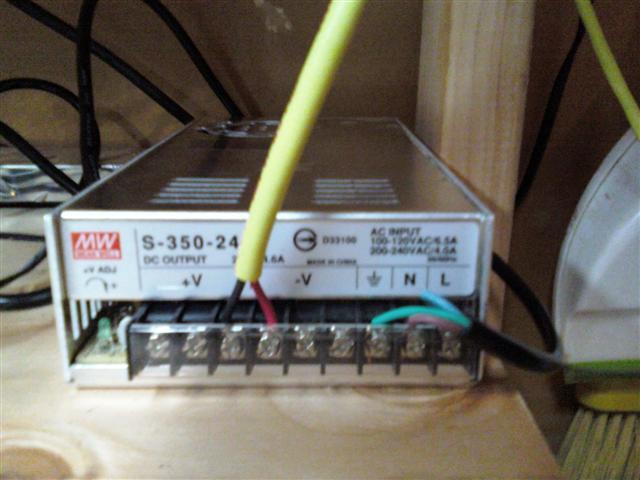

I hacked a battery and a Tool clip then attached it to a transformer to allow me the ability to use wall power while working in my garage.
It is actually quite simple and the transformer is only about $50 @ Ebay.com

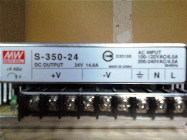

Not to quibble but you bought a power supply not a transformer. In your picture the rating of the supply is hidden. How much current can the unit supply?
You can't argue that it works for you. When doing something like this you need to ensure that the voltage and current capabilities of the power supply need to be "close" to what the battery supplied. Under or overvoltage or too little current can damage the motor of the tool.

This hack actually started by a mistake. I meant to buy a 12vdc one and bought the 24vdc model. I turned the adjustable voltage pot down and got to about 16 or 18vdc ( can't remember exactly) and was think crap what can I use this for... and I saw the 18v battery sitting there.
I have it adjusted to about 19vdc which is a tad lower than a battery at full charge. I have almost built an entire Teardrop at this point. and have not had any signs of damage to any of the tools. I have mostly used the circular saw, for all the plywood ripping and cutting. It can dog a bit if your forcing it through a piece of wood but no more than with a battery.
It is a little hard to read in the picture but it states 100-120v AC/6.5A

I read it as 24 vdc 14.6 amps output
120 vac 6.5 amp

Postby MceeD » Mon Mar 15, 2010 6:00 pm
pete42 wrote:I read it as 24 vdc 14.6 amps output
120 vac 6.5 amp
You would be correct.
In all the time I have used this contraption the cooling fan has not even turned on, so I'm pretty confident it is way more than necessary. But over kill has it's advantages :-)
