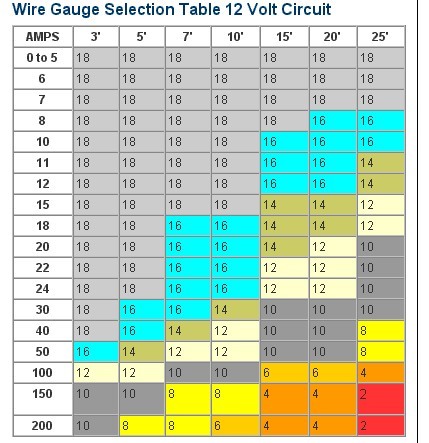

Postby Wolfgang92025 » Fri Mar 19, 2010 9:08 am
Some things to keep in mind.......
How long is the wire?
Is it in open air, in a conduit or raceway?
Duty rating, will it only run for 1 minute at a time with 10 minutes zero load, or have 24 hours continuous load?
Copied this chart for a previous post. Sorry but I can not identify author.
As you can see, run length has a huge impact on wire size. Hope this helps..
