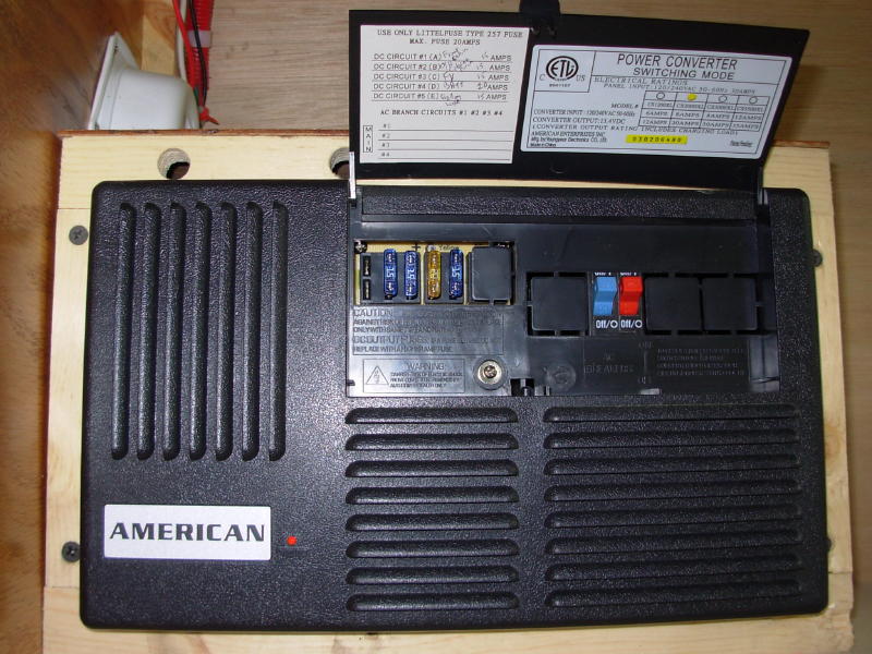

Postby 8ball_99 » Mon Apr 05, 2010 2:54 pm
I bought one of those like in the picture above for my Cargo trailer.. American 20 amp Paid 35 for it on ebay.. I've ran 3 lights, fantastic fan, water pump, and my radio cranked wide open with out missing a beat. Thats everything I have in the trailer..

Postby TPMcGinty » Mon Apr 05, 2010 3:18 pm
8ball_99 wrote:I bought one of those like in the picture above for my Cargo trailer.. American 20 amp Paid 35 for it on ebay.. I've ran 3 lights, fantastic fan, water pump, and my radio cranked wide open with out missing a beat. Thats everything I have in the trailer..
I have one too. Will power a lot of stuff and works great!
