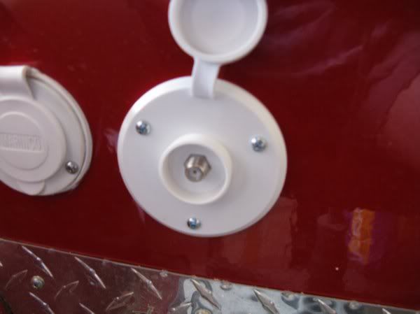

Postby bobhenry » Mon May 10, 2010 10:53 am
I took a double male apapter used to join two female ends.
I drilled a very snug hole thru the sidewall and used epoxy putty to afix it permanently.
Think I have a pic back in a minute !

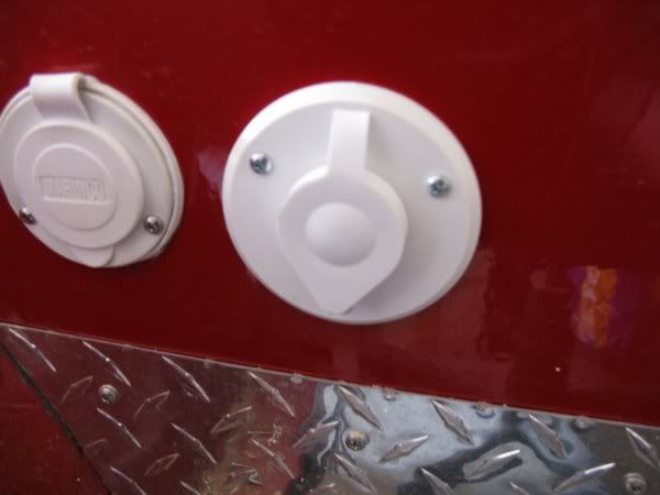

Postby planovet » Mon May 10, 2010 11:12 am
This is what I used:

Postby bobhenry » Mon May 10, 2010 11:30 am
Did I mention a small rubber protective tip can be slid over it when not in use. Use the flexible plastic paint to matck the trailer and you have a
no-see-em port.

Postby bobhenry » Mon May 10, 2010 1:20 pm
Reddiver wrote:I like both Ideas where do you get the cap to cover and where and what do you call the one you go Vet.. I am not sure what to call it to search for it.
The little bins in a good hardware look for protective cap or tips. Mine actually came on the end of some 6' survey stakes I purchased to use as the hoops fot the privacy screen roof in the picture.

Postby planovet » Mon May 10, 2010 2:21 pm
ImageMark (& Cindi)

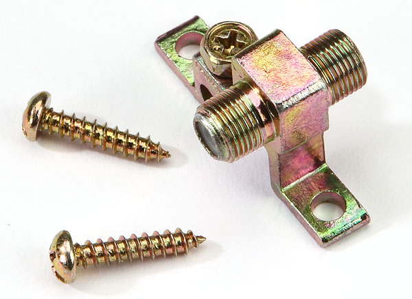

Postby bushido41 » Thu May 13, 2010 6:24 am
Hello Everyone,
Another option that might be easier to find is a "Coax grounding block", I have seen them in ACE hardware and I am sure the big box stores have them also. The beauty of this arrangement is you do not drill on the side of the trailer and also you do not have a wire dangling. This arrangement will give you a more fix and clean location for your coax entrance point.
