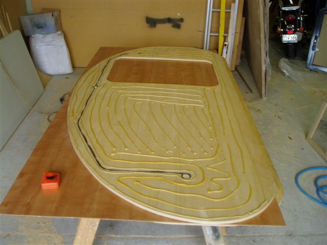

PaulC wrote:Image
Bingo..........................Just like magic
Cheers
Paul :thumbsup:
Now that is magic :lol: Thank You Paul :thumbsup: What thickness is your ply 20mm? Or is it thinner?

Postby PaulC » Sat Oct 23, 2010 5:34 am
Heikki, That pic is part of my No5 build. The wiring on this one is actually on the inside. The glue is for the veneer that I place over it. Same principle for the outside but you use aluminium.
Cheers
Paul :thumbsup:
