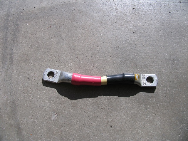

Here's a picture of a cable I made to go between the two 6V batteries in the Boxcar. I color coded the ends to show the positive and negative sides of the battery (yeah, I'm kind of anal about wiring)
