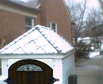

Here's what I started with (the angles of the roof, make this a dream to tow.)
(previous tenants)
There's the blank canvas...
What would you do with that and how would you proceed?

Cut new back doors in an arch and make a wooden door, with arched glass and faux rod iron insert
black gate hinges

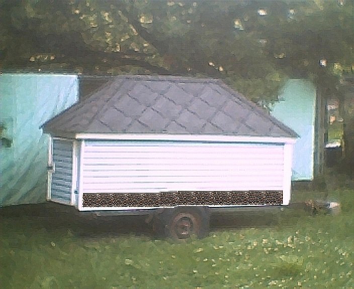

And you could always separate walls from floor, frame in a 12" knee wall, dress with faux stone so your elf cottage would have a stone foundation

I love the idea of the stone foundation, and the new doors. With an unbolt-and-raise-12" I might actually be able to stand up inside. I don't know about the chandelier, as head room is very premium, but rather than hang that from the ceiling, I might be able to embed a chandelier looking design right into the ceiling.

Postby PcHistorian » Mon Jan 30, 2012 11:26 pm
CGI with a stone foundation look.
I'm really trying to decide on the double sided door or window setting. Where is the best place for doors on this design, windows, height of walls, door, etc... (Interior.) If I just had the 6' peak to stand for dressing, I'd be fine, then maybe a bit more width for real cabinets... maybe a cooking corner with a range hood so I can cook indoors... or put a toaster oven, tiny microwave... As it is I may find a hot plate for a stove. single burner...
