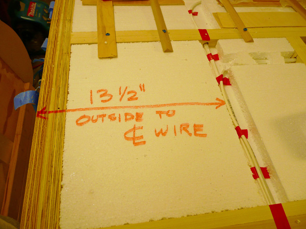

I like conduit. The big box stores sell 1/2", 3/8" (I think), and 1/4" clear poly tubing. I've used it as conduit and it works well. It's much easier to modify or change wiring when you have conduit run. The poly tubing is cheap and can be sized for the number and gauge of wires you need to run.
I've run a #12 bare wire through 25 feet of 1/4 vinyl tubing several times. This is a bit tougher than using the poly tubing. I blew dental floss through the tubing then used the dental floss to pull the wire. Took a bit of effort but saved over $50 as I repaired a TIG welder power cable rather than buying new.
When drilling holes in your spars, drill as close to the center as possible to retain as much strength as possible.
