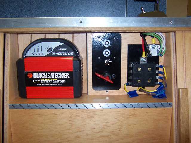

Postby madjack » Thu Jul 28, 2011 12:49 pm
On the first build, we used the panel mount, push button circuit breakers from Waytek...nice form factor, about half the size of a match box...we used an old piece of Formica, painted black for a panel front and mounted them in a cabinet...worked well for us at around 3bux/per........
