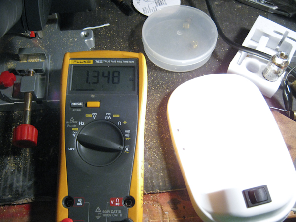

I started with some inexpensive RV dome lights from ebay. Search for rv dome light.
With the 12 volt bulbs they come with, they draw 1.348 amps.

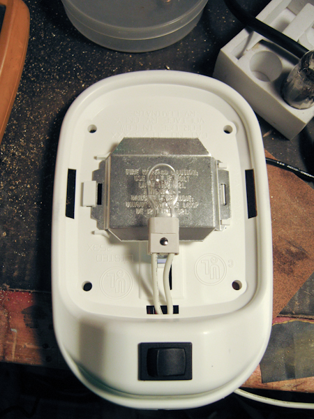

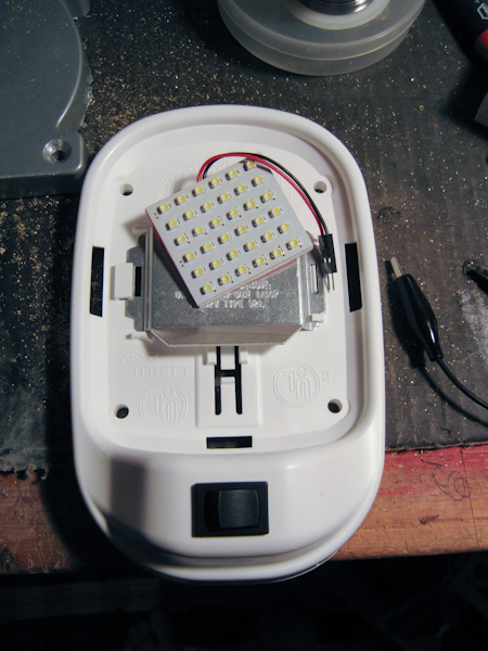

The bulbs are held in by a plastic clip and can be removed without any modifications or damage. I also bought a universal LED dome light conversion from ebay. There are a lot of different sizes shapes and configurations of LED dome light replacements for cars. They are very inexpensive. Search for led dome light. The one I bought had foam backed tape on the back. It fit perfectly onto the metal heat shield for the original bulb.

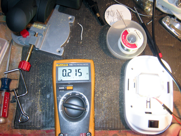

With the LED panel installed it only draws 0.215 amps or 215mA
