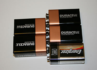

the red stripe is positive, take a pair of 9 volt batteries and connect one set of terminals together and then tough the wires on the pucks. will give you 18v plus verify which wire is the positive.

Postby Robbie » Thu Dec 01, 2011 6:10 pm
Hmm. Connect them together + to + and - to -? Or opposite? I forget which way will double the voltage. I was also thinking of just disconnecting my car battery terminals and touching the ends of the wire to the terminal tops. Is that a bad idea? :fb :?

Postby GuitarPhotog » Thu Dec 01, 2011 6:37 pm
Forrest747 wrote:the red stripe is positive, take a pair of 9 volt batteries and connect one set of terminals together and then tough the wires on the pucks. will give you 18v plus verify which wire is the positive.
Hooking five 9 V batteries together in series like that gets you 45 V, not 18, and exceeds the input rating of the LEDs. You can blow out the current limiting circuit in the LEDs by exceeding the rated input voltage by that much. javascript:emoticon(':oops:')
Your LEDs draw 0.35A of current, which at 12V is 4.2 watts.
You can hook your LEDs to your 12 V teardrop battery, but the one thing Forest got right is that you'll have to figure out which is the positive wire on the LEDs.

Postby Robbie » Thu Dec 01, 2011 6:41 pm
Ok thats some good news. Could I just use a single 9V battery to determine which wire is for sure the positive? Is that enough voltage to get some light output if its right?

Postby Forrest747 » Thu Dec 01, 2011 6:55 pm
Yeah the 5 batteries like that will give you 45 volts. Its the only picture I could find on google that explained my thoughts. Just 2 will do it. We also used the neighborhood kid to see if the batteries were any good. Just lick them my son told him. He hasn't been over to the house since we saw him crying and running from the house I used one battery to just get a dim reading to see if they work and what positive wire was which.
