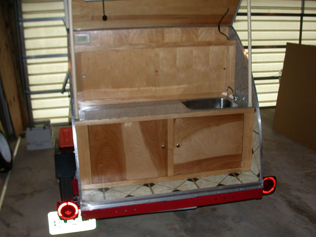

My hatch is sealed on the inside and I ran my wiring to a location near the hinge and came out there. Put a plug on it and then ran wiring up through the galley near there and have about a 8 or 10 inch section of wire (with twisted wrap on it) that shows and I can unplug the hatch if I need to take it off for any reason.
Here is a pic that shows it in the upper right corner

We did the same as toy pusher except I have wire drops on both sides.
