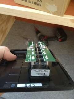

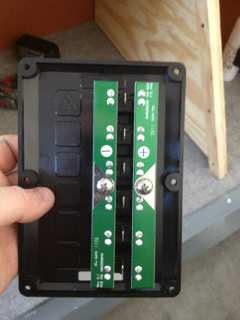

Postby burlesot » Tue May 07, 2013 6:06 pm
Help
Do I remove the green material to access the +\- terminals?
I know this is incredibly basic but I figure you all won't make too much fun of me....
Thanks
Todd

Re: Basic question. Embarrassing at that
Postby pmowers » Tue May 07, 2013 7:56 pm
Offhand, it looks like you would attach the leads to the screws with the large contact pads(triangular solder pads surrounding screws) in the middle. :)
I would use crimp-on ring connectors.
Postby burlesot » Tue May 07, 2013 8:04 pm
Ok
Get the main screws, but how do I connect to each circuit?
Postby pmowers » Tue May 07, 2013 8:10 pm
Didn't realize you would respond so quick, I added a link to the instruction sheet. The loads (positive) are attached using female spade connectors down the center of the board. The negatives are tied to the ground.

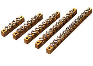

Postby bdosborn » Tue May 07, 2013 8:12 pm
Use female push on terminals on the metal thingys sticking up.
The ground is probably just for the lights, you'll need a ground bar for all your circuits.
You can get both at Home Depot.

Postby burlesot » Tue May 07, 2013 8:15 pm
Got a bar to use as a ground.
Thank you!
Postby burlesot » Tue May 07, 2013 8:17 pm
When you say metal thingy do you mean the one in the center of each circuit?
T
burlesot
Posts: 280
Images: 62
Joined: Mon Jul 16, 2012 3:10 pm
Postby bdosborn » Tue May 07, 2013 8:18 pm
Yup.
