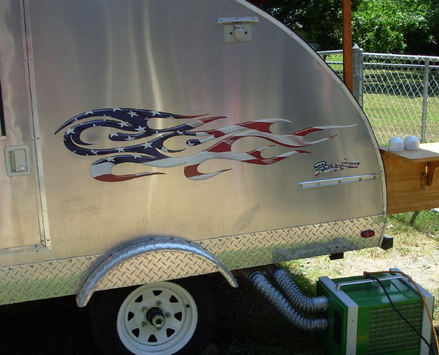

Postby Nobody » Fri Aug 09, 2013 9:57 am
The 30-amp 'trailer' plug is totally different from a 30-amp 'twist lock' plug/receptacle, & I don't know of any adapter that'll work with both?? Unless you really need 30 amp service, a standard Leviton 15-amp inlet will work fine with any standard extension cord, & adapters for the cord to fit 30/50amp power pedestals are pretty inexpensive. I installed a Leviton (under $10) 15-amp inlet on my TD just outside the converter location when I built my TD in 2006. Sealed behind it with butyl tape & installed a small homemade 'rain diverter' above it. Have never had a problem with moisture or being disconnected in 7yrs & more'n 20K miles of use...
