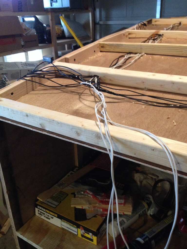

I have ran all my DC wires on my camper to the back ceiling. I have grouped the white and black wires together.
Now I am assuming that I need to make a hole in the ceiling and run the wires down the galley and wire them to the battery.
But I'm really confused as to how to run them from the ceiling down to the battery, then how to tie them all together and attach to the battery.
What do I do next?
I appreciate all of the help!

Postby 48Rob » Wed Oct 09, 2013 6:38 pm
One of your roof supports appears to have the wires under it?
Rob :thinking:
48Rob
Posts: 3882
Location: Central Illinois
Re: How do I put all of this together?
Postby tscarbroughdc » Wed Oct 09, 2013 6:49 pm
Yes! You are very observant!!! I accidentally use two different kinds of 1x2 and so I have a few spars that do not touch the inside ceiling but every spar will touch the roof when I put it on
tscarbroughdc
Posts: 120
Joined: Thu Apr 25, 2013 6:37 pm
Postby 48Rob » Wed Oct 09, 2013 6:52 pm
That's what it looked like...just wanted to be sure they weren't pinched...hard to get to later!
Rob

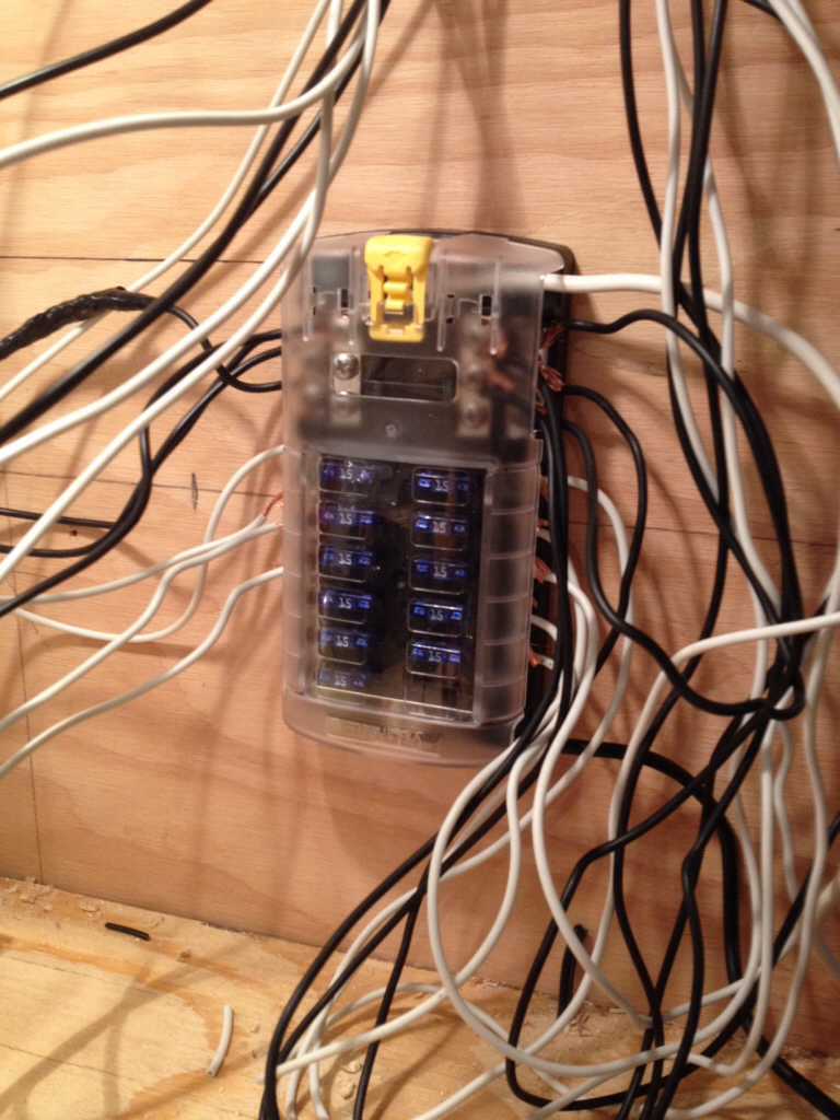

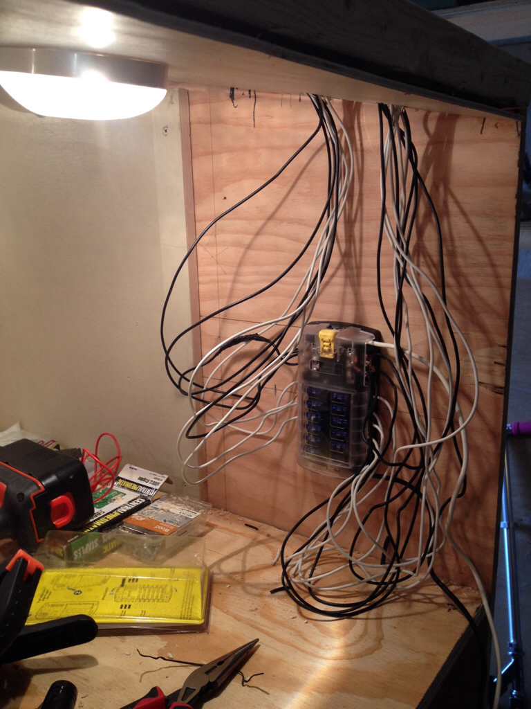

Thanks for the help y'all. I wanted to upload a pic of what I did with all of those wires!
tscarbroughdc
Posts: 120
Postby Shadow Catcher » Sun Oct 13, 2013 6:40 am
Label and neaten up. Mine came from the builder with a rats nest of wiring, hidden BUT. It is a pain when ever I have to work on wiring around the Progressive Dynamics power center.
Postby tscarbroughdc » Sun Oct 13, 2013 7:21 pm
Ok I have neatened it up.
Would someone show me a picture of the kind of fuse that is supposed to be put in between the battery and the fuse box?
I'm trying to figure that out now.
And it would be nice if there were some way to totally cut the power without having to unhook the cables from the battery every time.
tscarbroughdc
Posts: 120
Postby tscarbroughdc » Sun Oct 13, 2013 7:22 pm
Oh and one more thing!
Can anyone tell what I did wrong in the wiring from my picture?!?! Haha
I'm too lazy to change it though unless one of y'all say that my trailer will catch fire if I don't fix it!
tscarbroughdc
Posts: 120
