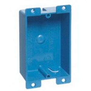

Look a little harder they make 1/2 depth boxes in the blue Carlon boxes. I think they are 1" to 1 1/4" deep.

I had to look hard at Lowe's the other day to find any. In fact, at one store I could not find any.

the only problem with the really thin boxes is that they do not have the "required" wire space for wires and the device. They make ones that have a side compartment that work better for this type of work, give you have the depth (1 1/2" if I remember correctly). The low voltage stuff, anything under 49volts, do not require boxes.

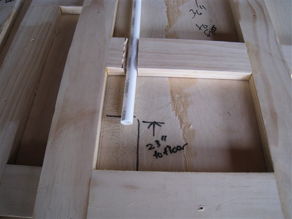

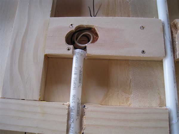

I didn't use any electrical boxes. I used a piece of water pipe as my conduit and left a hollow portion of the wall open. Once the interior skin was on I drilled a hole and pulled the wires through.
Here are two different examples: Note before installing foam to fill the voids except where the electrical wires came out

Postby George Taylor » Wed Jan 14, 2015 8:28 pm
I will assume that the previous pics are for low voltage (12 volt) outlets, correct?
