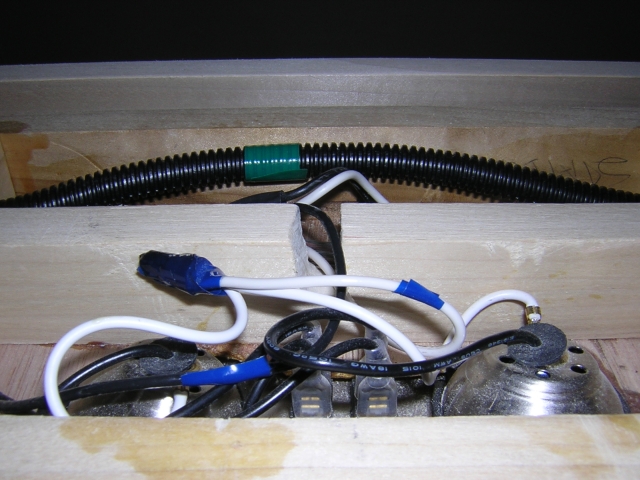

Here is a good shot of how not to do it. Look to the right at the edge of the picture. There are 5 circuits, some 12 volt dc , some 120 ac and switches for the DC and the AC outside porch light all crammed into a shallow single box. I needed an elephant to set on it to get the cover on. It looks like the one directly across on the far wall. I did use a flip switch for the ac and a rotary for the dc so I could tell who was who in the dark by feel.
Here is the DC porch I did use an 1156 amber " bug light " :laughter:

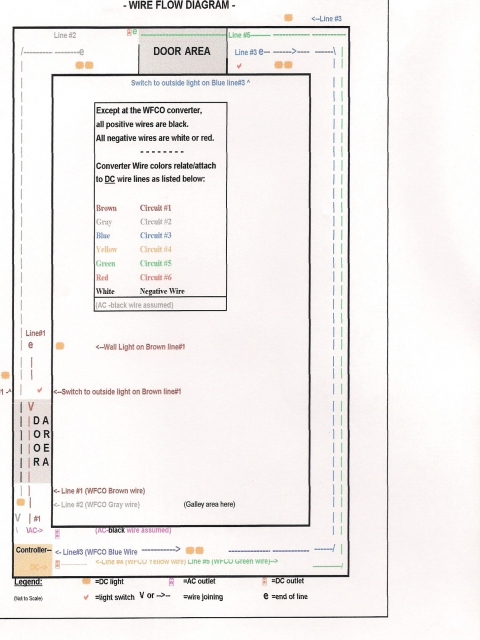

Although my build is not the normal build because of the roof, I did document my wiring, nearly every step of it, in my photo gallery.
I started by calculating what I thought I needed (back before LED):
Then, I made myself a colored drawing:
Then, I bought colored electrical tape and matched my wiring to the colored drawing so that at any connection area, you can see which line it is, where it goes and what it is used for...:
I took pictures of everything that I could think of. I even documented soldering and heat shrink sleeves, tools used, etc. In my own way, I did the best that I feel I could.
