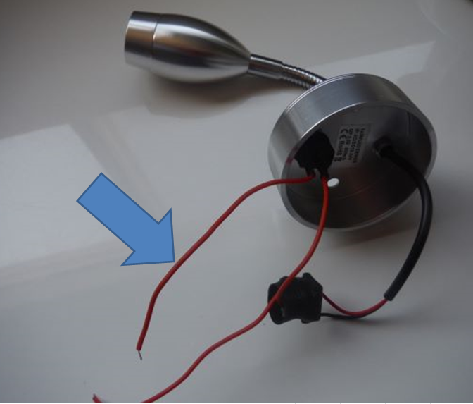

I get it: When there is a red and a black, the red is hot. When there is a black and a white, the black is hot....except for AC where the white is hot.
Are you with me so far??
I'll admit that everything I know about electrical systems I learned by sticking my tongue in a light socket! Just when I thought I was getting a handle on this electrical thing, along comes a Chinese reading light with two red wires.
reading light.PNG (316.46 KiB) Viewed 3219 times
I'm going to take a wild guess here: When you have two red wires, the first one that goes to the switch is HOT......right??????

Postby tony.latham » Wed Mar 04, 2020 1:07 pm
If it were me, I’d guess with a multimeter.

Re: Just when you thought it was safe to go in the water...
Postby tony.latham » Wed Mar 04, 2020 1:18 pm
I’d test for continuity on those two wires with the switch in both positions.
If it’s a DC LED you might play with a nine volt battery and work it out that way.
What’s with the other pigtail?
Postby GuitarPhotog » Wed Mar 04, 2020 1:19 pm
If it's an LED, you won't hurt it by briefly connecting it backwards. Just try it, with the + to the switched lead first.

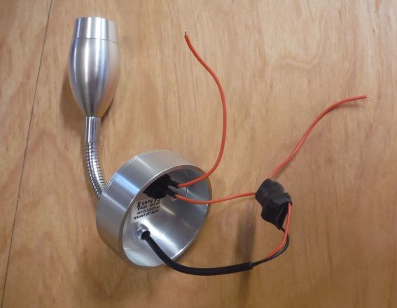

Postby Tukanu » Wed Mar 04, 2020 2:44 pm
The picture makes it look like there are three wires, but there are actually only two...both red!
I touched it to a 9volt and it lights up both ways + and -
Postby edgeau » Wed Mar 04, 2020 3:43 pm
Well it must be an old fashioned bulb not an LED. It does not matter which way the power flows in a bulb but an LED will only work one way. What is the other connector with the black shrink wrap on it?

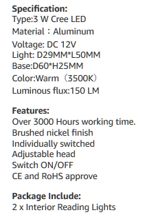

Postby Tukanu » Wed Mar 04, 2020 4:32 pm
It is supposedly a 12v LED reading light from Amazon. Inside the shrink wrap is a small circuit board.
Postby edgeau » Wed Mar 04, 2020 6:13 pm
That circuit board must be doing some smart stuff to give the LED the right polarity regardless of which way you hook it up.

Postby Tukanu » Wed Mar 04, 2020 6:41 pm
Here are the spec's from Amazon:
Postby Tom&Shelly » Wed Mar 04, 2020 7:06 pm
edgeau wrote:That circuit board must be doing some smart stuff to give the LED the right polarity regardless of which way you hook it up.
Sent from my Pixel 3 using Tapatalk
A full wave rectifier so it will work with 12 vac? Even though it isn't spec'd that way? :thinking:
