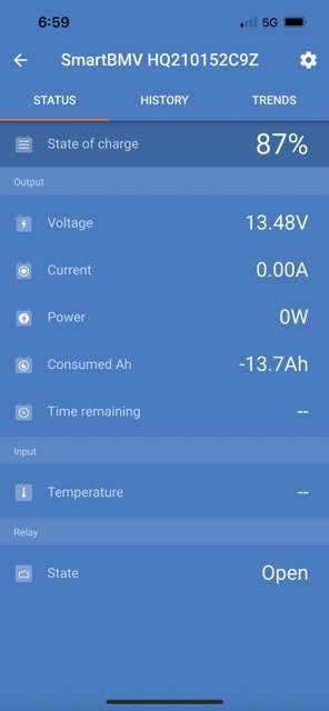

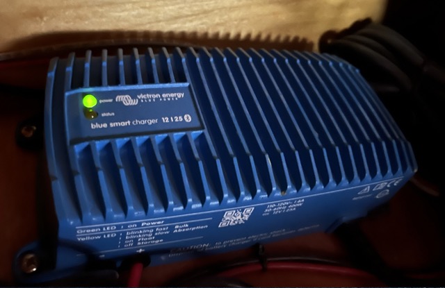

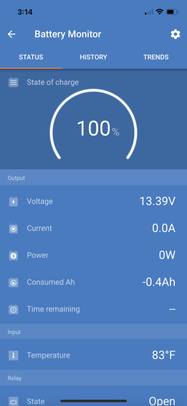

I have a 100Ah Battleborn Lithium battery (basically new) being charged by a IP67 Victron charger. I just returned from a camping trip the battery had 48% left. When I returned home yesterday I plugged into my "home base shore power" to recharge the battery. The state of charge got up to 87% and now seems to have just settled on that (since yesterday afternoon) and the Victron monitor is reading 13.48 volts.
Any thoughts about why the battery stopped charging at 87% and why the battery voltage is not getting up to around 14 volts? And why the green light on the IP67 charger is just a solid green and not blinking (which it usually does when charging). Even when I unplugged the the shore power the green LED stayed on (on the charger) which I don't recall it doing in the past. All equipment is basically new. There is nothing "on" in the trailer which would be drawing power.
Maybe all is as it should be and I'm just not understanding "how these components work"??
Thanks for any insights. attached are 2 pics which might be a help.

Hi John,
I think it is a settings issue either in your smartshunt or the charger, and that the battery is actually full. I’ll check my own settings (which I got from Andy on Off Grid Garage) this afternoon for you when I have a chance. Bruce may beat me to it!

As a follow up, I removed the charging cable disconnecting the shore power. As mentioned in original post, the green LED stayed illuminated on the charger which I was wondering why is that still laminated even though I disconnected the charging cable. I just went and checked the charger and the green LED is now out on the charger..... so maybe it stays lit until it completely discharges any current running through it, even when it's first disconnected.

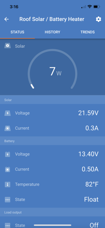

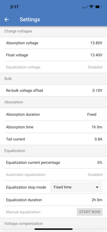

I pulled up the relevant screens from my Victron battery monitor and my solar charge controller (which can basically stand in for your shore charger because the settings should be similar). My settings came from Andy's Off Grid Garage chanel on YouTube, probably cobbled together from various episodes. I'm interested in keeping my battery viable for as long as possible, so I'm being more conservative than Victron's default settings for LiFePO4, thus it shows up as "User Defined". I started with those defaults though, and then went in and tweaked some things.
Battery Monitor / Smart Shunt:
My battery shows up as 100% at 13.40 volts because that's how I have it programmed.
Charged voltage: 13.8 V-- this should be set to the same value as the absorption charge level on the charger. If it is higher than the absorption voltage of the charger, it will never get to 100% on the meter, even though it is full (what I think is going on with yours).
Solar Charge Controller / Battery Charger:
Note the charger is in Float stage right now. It charged up this morning and went through bulk and absorption before 11 AM. It has been in float ever since. In float, the charger just replaces any current being used, like the 0.5 amps being used by my Venus GX & mobile hotspot (my raspberry pi's).
Absorption: 13.8 V - the highest level I let the voltage charge to (lower than Victron's LiFePO4 default)
Float: 13.4 V - the maintenance voltage the system spends the day in is lower than absorption to not stress the battery out
And in expert mode:
Re-Bulk: 0.10V - how low below Float voltage the battery gets before it shifts back over to bulk charging
Absorption duration: 1 hour - max how long it stays in absorption before going to float
Tail current: 0.8 A - how low the incoming charging amperage is before it goes into float (this usually makes mine change from absorption to float in about 15-20 minutes)

Edit: after fixing the charged voltage to equal the absorption voltage, the battery monitor should read 100% after you charge it the next time. It will synchronize itself so you don't have to, or you can press the "synchronize to 100%" button if you know the battery is really full. You should not have to manually reset it on a regular basis.
Edit #2: Andy from Off Grid Garage has shown that the absorption & float voltages of 13.8 and 13.4, respectively, keep the battery in a state where it retains most of its stored energy (more than 90%) at full charge, but doesn't let the battery get up into the steep section of the charging curve. In practice, he (and I) found that charging to 13.8 V instead of 14.2 V sacrifices only a couple of amp hours of total storage at the top end, if even that much. But charging to lower voltage should keep the battery well away from the high voltages where degradation can occur if high voltage happens often (like every day it is charged up by solar). That's also why I reduced the absorption duration and set the tail current, so the battery spends less time hanging out at higher absorption voltages. The difference in practice in terms of battery capacity is negligible to me. The trade off is that battery cell balancing by the BMS needs higher voltages, so normally this step would be done at absorption voltages. But I can tell you my battery's delta is still only 0.001-0.002 V when fully charged, so it has never needed active cell balancing. (This is why I top balanced the cells in the first place before putting the battery into service, and it has stayed perfectly balanced after almost a year.) Andy has tested lower voltages than 13.8 absorption / 13.4 float and it is not worth going any lower than that-- these numbers seem to be the sweet spot for maximizing capacity and minimizing potential degradation.

Postby lfhoward » Sun Jul 17, 2022 6:38 pm
That’s it. If your monitor thinks fully charged is 14.6 volts and the charger stops charging at Victron’s default 14.2 volts, it can only get 87% to a full charge. :thumbsup:

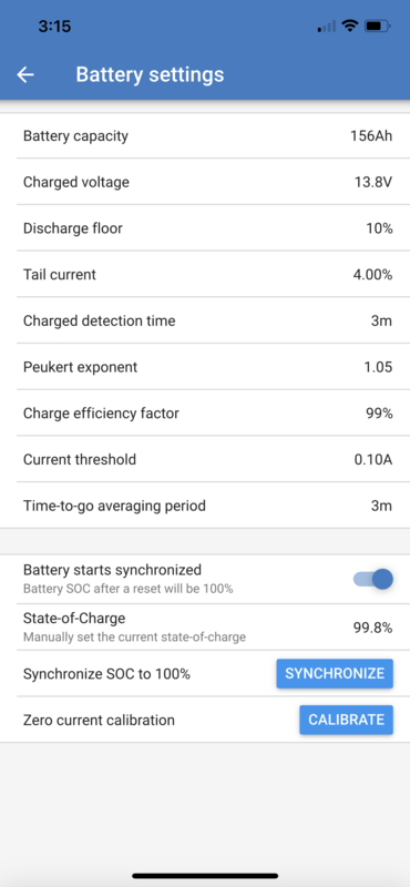

Here's an image of what my current battery settings are configured at:

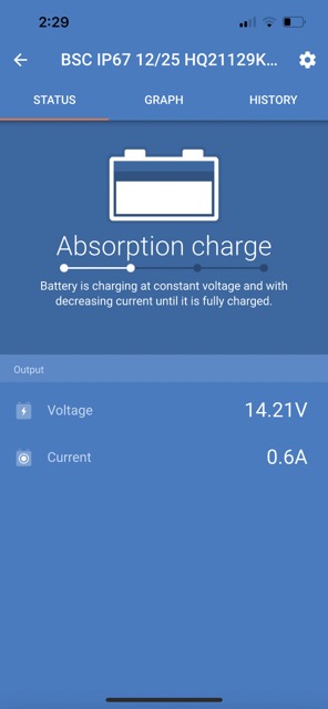

Here's the image when in absorption mode:

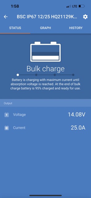

and here's the image when in bulk mode:

In the IP67 Charger there's a few settings I can choose for the "Charge Preset". I chose "li-ion". Hopefully that is correct:
That same page on the charger settings gives an option for the "charge current", either 10A or 25A. I chose 25A. Battleborn says you can charge a 100Ah battery at 50amps but probably not wise to do that all the time and I don't see how you would do that anyway (maybe under the "advanced settings".
Regarding your comment about the temperature setting.... one regret I have is not getting the heated version battery. So you suggestion of getting the temp sensor might be good. I think I remember Battleborn's built in BMS will not allow charging if the temp is under 32 degrees.

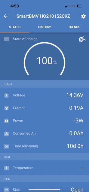

He walked me through the appropriate settings and did it in a very helpful way. There's a bunch of Victron components listed under a demo tab on the app. I found my components and basically set them up (with his help) and then took a screen shot on my phone of the settings. When I got out to my garage I was able to refer to the screen shot and fine tune the setting on the app on my phone..... setting the absorption voltage(14.4 V) and the float voltage (13.6V) and the storage voltage (13.2V), which I'm not sure I had correctly noted before.
Attached are new images of what the app is now showing me. The charge is up to 100% and the voltage is where it should be (around 14.4 volts). Also attached is a screenshot of the settings in the BMV712.
Thanks for all the help and suggestions.
