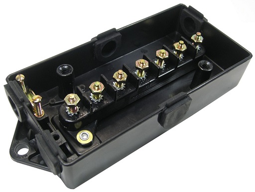

Postby working on it » Sun Jun 22, 2014 7:43 pm
Dale M. wrote:I'm thinking its added complexity and another place to cause a problem and you don't need it....
Dale
However, if it simplifies the wiring and keeps it tidy, then it my be a boon...Dale advised me to try using one, previously, in an earlier thread http://www.tnttt.com/viewtopic.php?f=21&t=58985&hilit=spectro&start=45#p1072104(suggested also, here, by Esteban). I used this one: http://www.etrailer.com/Accessories-and-Parts/Spectro/38656.html
Spectro 7-way.jpg (53.39 KiB) Viewed 691 times
It was a life-saver.
