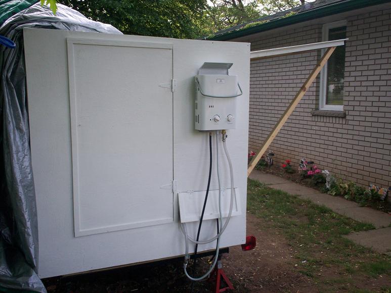

I too have one of these units. Mounts on the side of my TTT, and with deflector does not heat the painted wood any significant amount.
I have since added a 'Y' adapter so that it can feed the sink or shower head. The 'Y' adapter selects one or the other. Since the shower hose/head that came with the unit (as most others) is only about 6' long, I picked up a couple others from garage sales, and joined three hoses together with union type couplings. Now more than long enough to reach into the privy shower tent.
So far the unit has performed flawlessly. But as they mention in their user guide, you have to be mindful of less flow = hotter water. But I find my on-demand pump cycles too much with low flow. I will install an accumlator tank to handle that problem.
