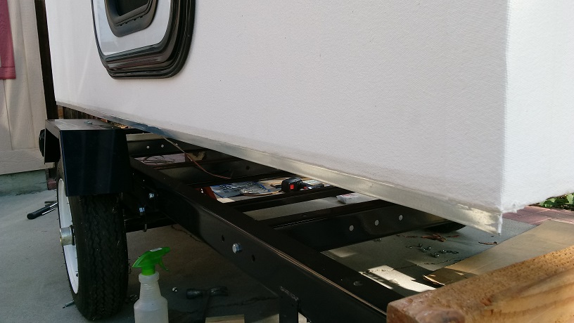

Re: Bug Out Trailers (A simple foamie)
Postby ghcoe » Sat Oct 20, 2018 8:54 pm
To eliminate the moisture trap between the body and the frame, and to make room for the drip edge, I have installed cross members between the trailer frame and body. Using 1"x2"s I lifted the body 3/4" above the frame and installed a drip edge around the bottom edge of the body, effectively eliminating the moisture trap. This will also prevent the frame from possibly rubbing through the water resistant barrier and/or canvas from the constant movement of the frame against the body.
drip rail
I did also have to install what I call inner frame rails to spread the load along the floor better. With just 5 points of contact with the cross members it created too much stress on the foam, I had some delamination at those points after my first trip out. I installed the inner frame rails and on the next trip I had no issues at all.
George.
