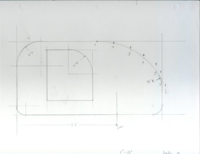

Postby mikeschn » Tue Apr 26, 2005 8:20 pm
I'll definitely have a drawing for this post... The front radius will be equal to the back radius... it appears to be about 16", but I'll confirm that for you once I start modeling it.
Here's a rough sketch of a Benroy profile... I'll be doing a simplified version of that for the generic plans.
It'll end up looking very similar to this...
Postby SteveH » Tue Apr 26, 2005 8:55 pm
Mike,
You just MUST keep the back end eliptical. It just won't look right if it's a simple radius. It won't be a Benroy then, it would be a Rimple.
Just my "opinion" of course.
SteveH

Postby mikeschn » Tue Apr 26, 2005 9:01 pm
We could always call it the simplified Benroy... or is that rimplified Benroy? Andrew, what do you think? Should it be ellipitical or what?
Postby Chip » Wed Apr 27, 2005 4:45 am
Heck since its a variation of the original,, Go for the glory and call it a Mike-L-Roy ! Sort of has a nice ring to it too,, dont ya think,,

Postby angib » Wed Apr 27, 2005 5:59 am
mikeschn wrote:Andrew, what do you think? Should it be ellipitical or what?
I'd say steer clear of ellipses - I like the look but they do seem to scare people off and this is meant to be an easy trailer.

Postby SteveH » Wed Apr 27, 2005 7:20 am
Andrew
Andrew,
Using your string and pencil method, drawing the elipse when I built my trailer was the easiest thing I did!
SteveH

Postby JunkMan » Wed Apr 27, 2005 9:03 am
SteveH wrote: Andrew,
Steve I agree, but I did have a little trouble figuring out where to put the loci (locuses?). I really think the ellipse adds to the look, and if the loci are given, it shouldn't be too hard for a beginner to do.

Postby mikeschn » Sun Oct 09, 2005 5:45 am
type82e wrote:great info! photos would be even better
what is the front radius?
marcel
If anyone is still looking for drawings for this step... I've posted 3!
