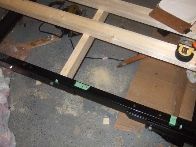

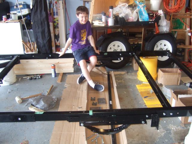

Postby Sparksalot » Fri May 16, 2008 9:29 pm
jp03 wrote:I decided to use 24 inch extension. Will take 1 1/2 inch angle, cut to fill the 24 inch gap on top and bottom of inner frame "C" channel (welded) as an extra brace. Figure this will stiffen the horizontal flex and make up for the slight differance of metal thickness. With two foot added, the axle fits just at 41 inch from end, with no modifications but a hole or two needed.
The Working Stiff is sitting on the extension here.
More close up detail. You can see a bit of the 1 1/2" angle I put in as well.
I salvaged the angle from the brackets that would have been used for the casters if the trailer had been set up for folding.
