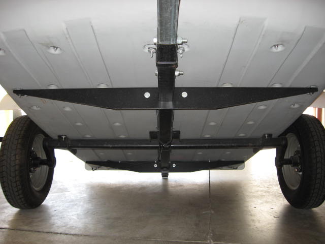

Here is a pic of mine

So why are the bracing for the tongue located at different locations? Where they join to the 2nd crossember?

Postby eatatjoz » Wed May 19, 2010 12:10 am
Looks like a perception thing.
If I was to guess, it's a 3x3 frame flipped upside down and the camera angle just makes it look offset.
Just a guess though.

Postby dh » Wed May 19, 2010 5:33 am
Yep, it's upside down, just a trick of the camera. I'm mobil tonight but I'll put up a different angled pic tomorow night when I'm at work.

Postby dh » Wed May 19, 2010 7:06 pm
Well, I guess this is the only other pic I have that even remotely shows the tongue members. Still can't really tell though. I guess you will just have to trust me that they are evenly spaced on the 2nd Xmember.

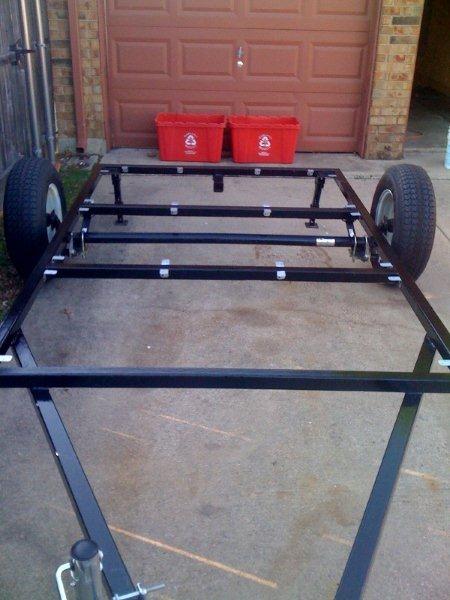

Its not new, but here you go: :D

Postby WesGrimes » Fri May 21, 2010 7:35 am
teardrop_focus wrote:Image
:dancing
Those two pics are so fresh that I haven't even started a build thread yet...
:lol:
That is a great looking frame design!
