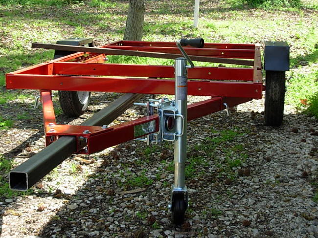

There have been several threads on extending the tongue on the HF trailers. The tubing required is 2"x2". Thanks to Harvy (Nobody's Teardrop), here is a pic of his frame with the job almost finished.
Can anyone tell me what thickness the tubing wall should be?
I'm hoping to get this project done before the next outing.
Thanks,
Mike

It appears to be .120 or .125 Doug

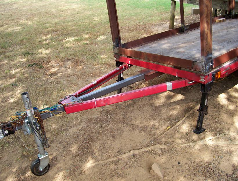

Postby Nobody » Wed Jan 26, 2011 1:57 pm
The tongue extension on my TD extends 16" forward of the original HF 'A' frame. With the coupler it is 21" forward of the original. It is 2x2x1/8" & thru some 12K miles & some pretty rough roads, no untoward bending or flexing :thumbsup: . I attached the safety chains with the forward horizontal bolt that I used to attach the coupler to the tongue. As for the A-frame mounted tongue jack, I've had no problems with it. Of course it isn't the primary support as I have the BAL stabilizers on each corner that I deploy immediately upon un-hitching from the TV. I have re-positioned the TD by hand over some pretty uneven ground/pavement & have not noticed any 'give' or undue flex of the jack.

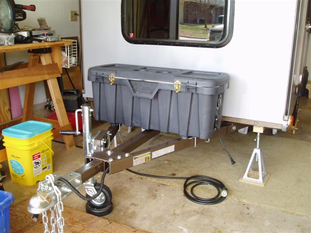

Postby ARKPAT » Wed Apr 13, 2011 7:36 am
Harvey has inspired all of us in the HF tongue extension ...... this is not my new trailer extension buy my buddy's trailer. That was inspired by Harvey's extensions.
I will try to get the pictures of the one that is on my trailer and new tongue box........ I was in a hurry to get the tongue extension do before BB gathering.
