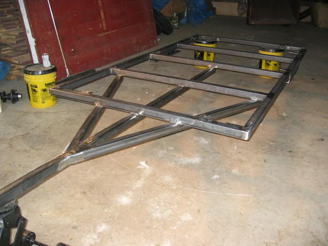

I have had the steel for this trailer 4 weeks. Just waiting for my brothers company to cut and weld it. Well Saturday we cut all the parts and today it is finished. I am going to use Rustolium truck bed Epoxy coating. I biult the floor and wall frames while waiting so I hope for no snags in fitting them together. Here are a few pics. I know ya like da pics!

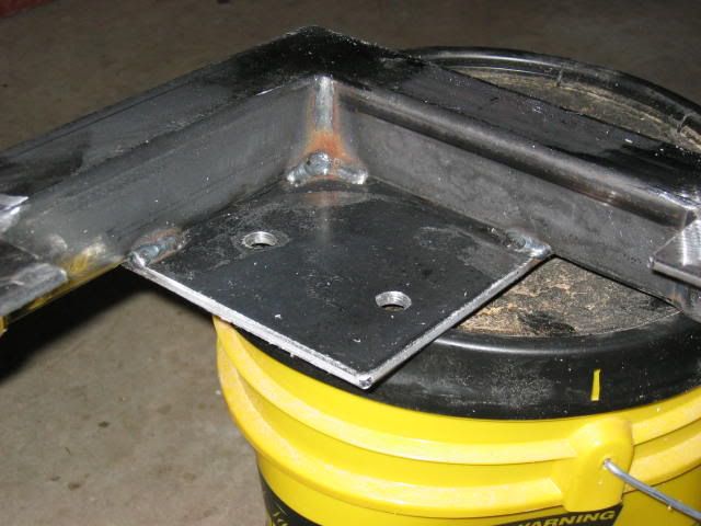

Here is how the corner gussets look. I am using the Atwood corner jacks.

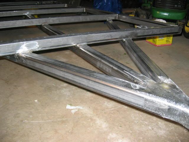

Here is a pic of my tongue A frame. I used 2x2x.250 for the tongue.
