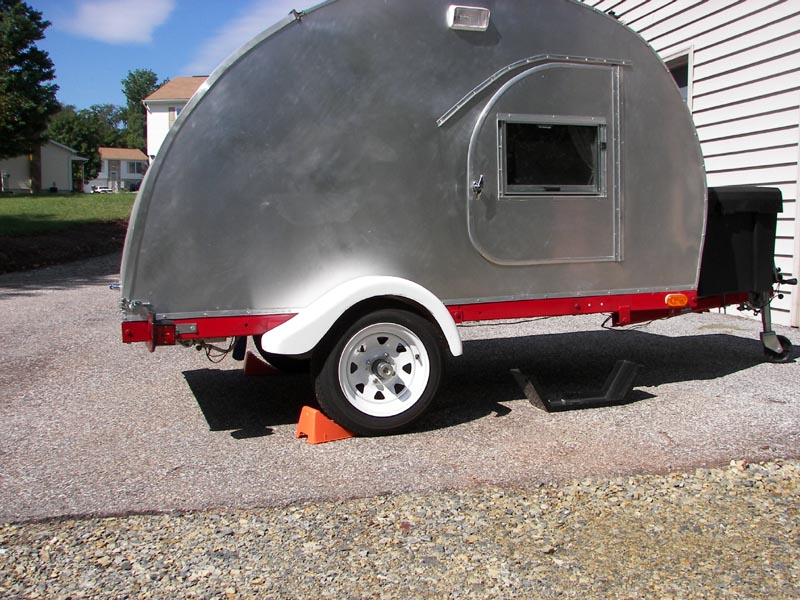

Maybe you just need some 'cool' fenders that fit small wheels!!
PS: please excuse the white color, I did not paint them yet!
mikeschn wrote:Bigger wheels? Something like this?
Just kidding!

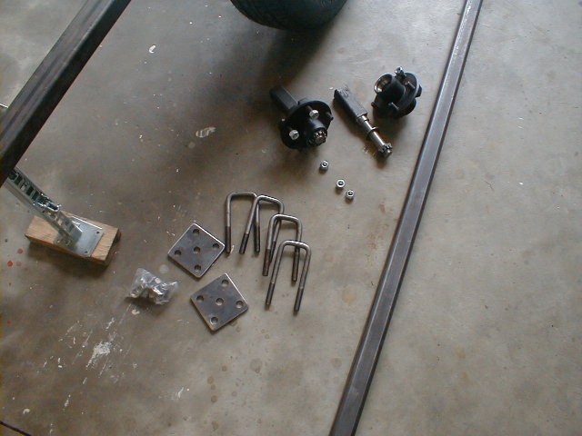

mikeschn wrote:You're talking about this one, right?
