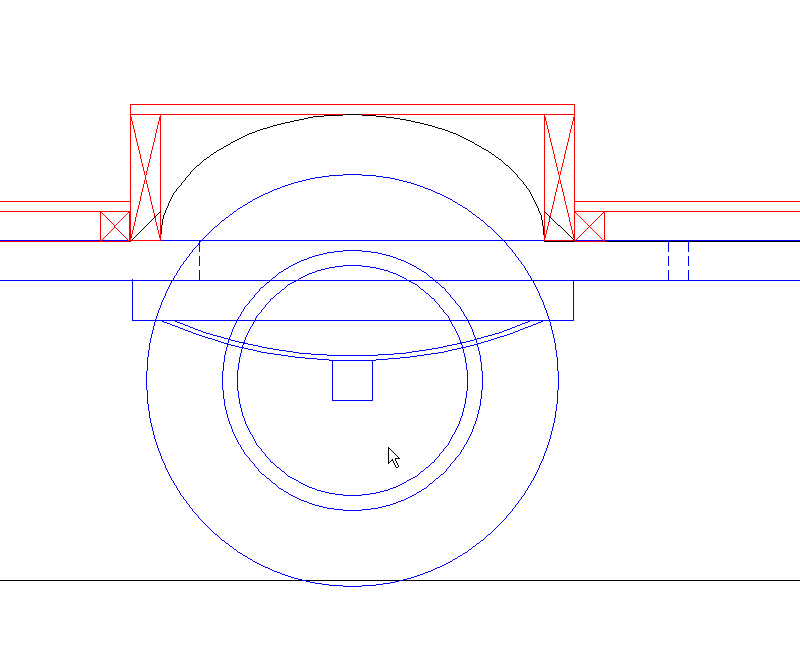

dxf drawing of a HF 90154 1195lb 4x8 trailer
Postby mikeschn » Fri Feb 19, 2010 6:21 pm
Postby mikeschn » Sat Feb 20, 2010 5:42 am
I just opened up your file and looked at it. Looks like it should work. It seems a little tight, but you've got your 3" of clearance. Maybe if you chamfer the wood so there is no chance the wheels touch the side pieces.
That would also give you other options for your wheel well cutout! :)
Postby starleen2 » Sat Feb 20, 2010 11:32 am
You could place a snubber bushing on the axle or frame to limit the spring travel to only 3 inches
