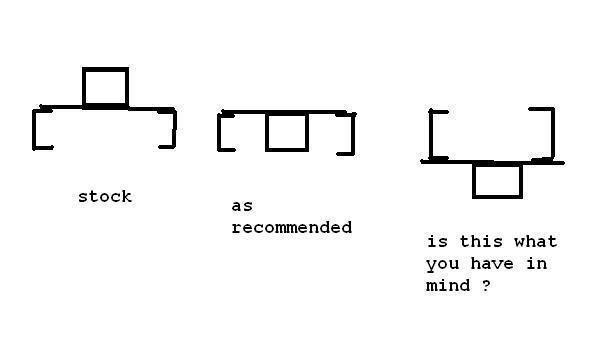

Just a quick question is everyone replacing the coulper with one for 2" or are you shiming the original?And has anyone fliped the original bracket to lower the tube another 2"and placed the 2"x2" threw the original bracket?

Not sure exactly what you're asking in part 2 of your question. I 'flipped' the original coupler & modified (with a grinder) the 'A' frame members so it'd fit between 'em', & ran the tongue ext thru the original coupler (see pic in first post of this thread). If you're asking about flipping the original coupler & bolting it to the bottom of the 'A' frame members you'd hafta devise a 'spacer' to go under the first 2 cross members (or whatever you fastened the back end of the ext to on the chassis) in order to maintain 'level' for the tongue length. You'd probably also need additional side support for the tongue ext at the rear to avoid possible excess lateral stress?? I'd think it'd be easier/simpler to just use a 'ball mount' that would place your ball at the correct height to tow the trailer level.

Postby bobhenry » Tue Jul 26, 2011 10:43 am
I see what Harvey is saying and I think I agree that it sounds like you want to go to picture #3
If you install as picture #2 shows you will plane out directly below all the crossmembers giving you a place to bolt ( or weld) the new tongue to.

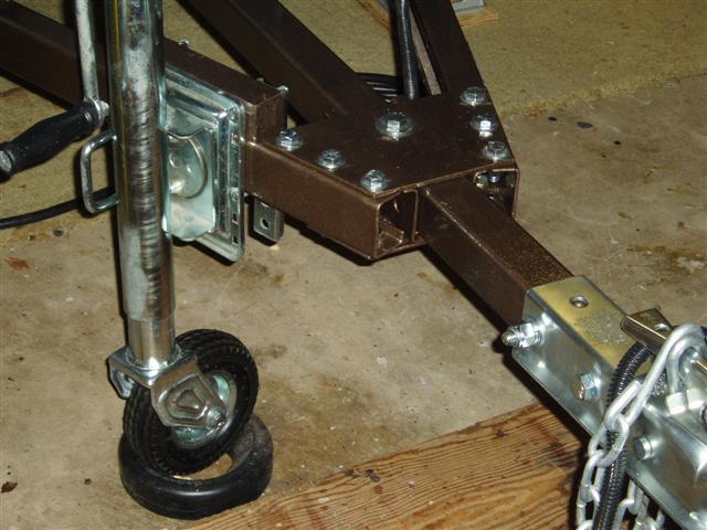

Postby absolutsnwbrdr » Mon Aug 15, 2011 8:01 am
I updated my build thread with this, but figured I might as well put it here too.
I finished it up on Saturday afternoon. Took longer than I thought it would.
3/16" is fun to drill through. :?
The steel I used was 7' long ($32.99). Its bolted to the front and second frame cross members, as well as the original coupler mounting bracket, with Grade 5 nuts and bolts. I replaced the HF coupler with one designed for a 2" tongue ($19.99). Overall extension moved the coupler location forward about 23", which ended up being PERFECT length to allow for the relocation of the tongue jack. If it were much shorter, the jack would not be able to fold up and lock into position.
To anyone who decides they want to do this: Give yourself plenty of time. Use carbide drill bits. I used 1/4" and then 1/2". Use cutting fluid. Drill SLOWLY so you don't destroy the $20 1/2" carbide bit.
I've needed to repaint the tongue for a while, so that red plate will be painted as well. The weather this weekend didn't allow for that.
Also... when you move the coupler from its original position to the end of the steel tube extension, it raises your tongue height by 2". My teardrop now sits much more level than before. I know this can be achieved by a hitch draw-bar, but I don't think anyone mentioned this change in height before. I guess its obvious to most people, but it wasn't to me.
