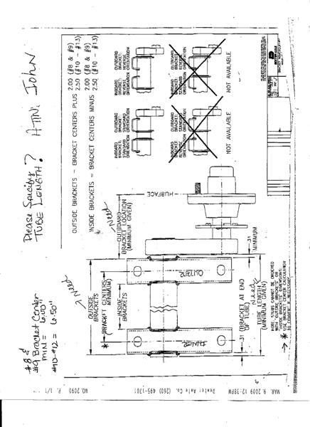

I thought I would add this info. that Dexter faxed me. They requested some dimensions that are labeled "needed" in pic below. In the end I went with the flexiride UCF over the torflex from dexter as it was less expensive.
