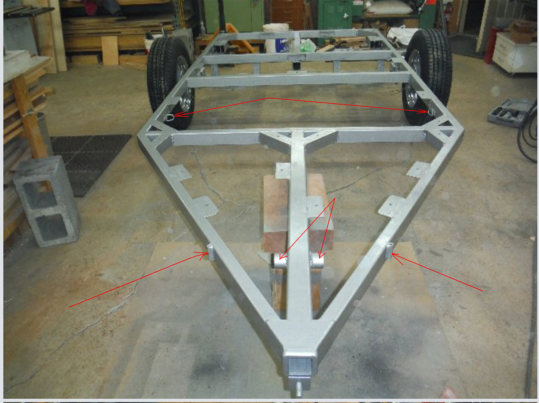

Postby Capebuild » Sun Feb 07, 2021 6:25 am
Thanks for your post, HalfDomeDanny. Beautiful trailer! I went to your webpage of your trailer's photos. Really nice.
I had a question about some of the weld-ons. I attached a screen shot with red arrows pointing to them. Not sure what they are for and asking if you can tell me what their purpose is. Thanks!
Also, the method you've welded your frame with the tongue in-line (on the same plane) as the other members.... I wonder if that provides the same strength as having the 3 tongue members
welded under the frame, as I've seen in most other trailers. I was just asking for your thoughts on that. In my mind it looks like it puts more stresses on those welds where the tongue members are welded.
I really don't know, so I'm asking what your thought process was in choosing to do it that way. Again, Thanks!
John

Re: Build or Buy Chassis Frame
Postby Ottsville » Sun Feb 07, 2021 7:18 am
John
His frame is plenty strong enough for a trailer with a fixed load on it and a light one at that. Tongues running underneath trailer members are a good idea for situations like trailers where you load and unload a trailer from the rear- think atv's etc - and create a levering force on the tongue. Remember, many people are not engineers or want to spend the time or money to figure out where forces act on their trailers(or any build) and just go with "more is better" thus overbuilding.

Postby halfdome, Danny » Sun Feb 07, 2021 10:34 am
Capebuild wrote:Thanks for your post, HalfDomeDanny. Beautiful trailer! I went to your webpage of your trailer's photos. Really nice.
John
Hi John, thanks for the kudos, Picturetrail is closing down sometime this month so my albums will disappear. :(
The 2 weld on attachments on the front of the tongue are some of the attachment points for my rock guard.
The 2 "D" rings are to attach a bungie chord to hold my lantern shepherds hook or if someone wanted to tie up a pet.
The pipes on the 4' hitch receiver are there to protect my tongue pin lock from being tampered with, my tongue extends with a 2" x 2" x24" piece of tubing.
When I was in the process of designing my first teardrop back in 2005 Grant Whipp was quite the respected expert in the teardrop community.
When we visited his shop he had made over 35 teardrops at the time.
I have a friend near by who made something like 47 teardrops and his tongues are in line with the rest of the chassis.
My profile is his Lil Bear profile, a modified Benroy.
I gleaned my chassis information from him and others at the time and the tongue under the chassis just didn't look like something I'd be comfortable with.
The first 3 mounting tabs are for mounting the tongue box, the second (3) tabs are for mounting the floor.
The grade 8, 3/8" bolt in the very front is a second removable tongue attachment point that removes any tongue rattle.
My floor extends about 18" past the first cross member with 9 attachment points.
I'm sure both tongue orientations are safe, just a personal preference.
:D Danny
