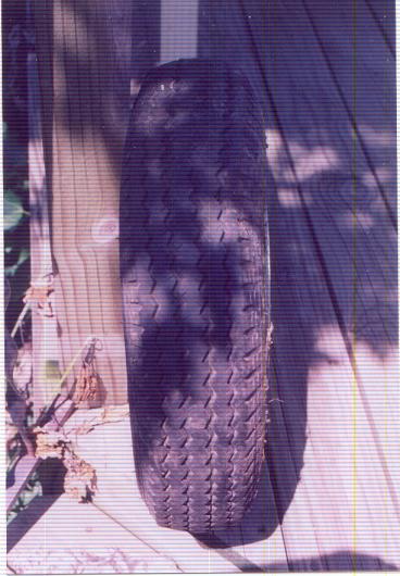

My initial thought was that if enough parent metal of the axle shaft had been moved or removed by the seizure of the bearing it would allow the inner bearing to rock but upon rethinking the outer bearing which was not damaged would help to stabilize the hub. After rereading previous posts "there is no side to side play" so bearings must be seated on the axle shaft securely. Could this be cause and effect. trailer slams sideways into a curb or other immovable object flat spotting the mashed inner bearing and bending rim and/or hub flange, perhaps just a broken belt in a tire. This wiggle beats the hell out of the bearings until final failure and seizure. No one mentioned broken belts in the tire yet !
This one let go internally and was rubbing inner frame AND outer fender!
Nothing like the smell of burning rubber at 3 AM on the road in 4 degree weather.

I see your pics now, Bob. Thanks for reminding all of us to use better-quality trailer tires!
